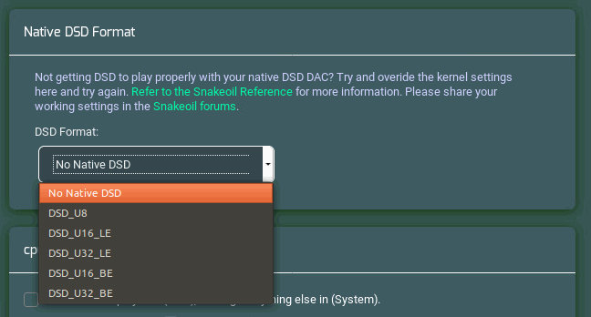

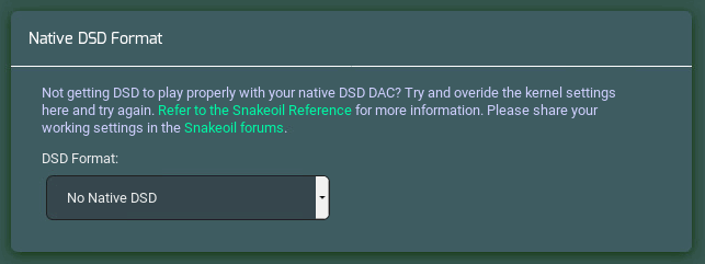

If you are using the custon native DSD kenel, a special panel called "Native DSD Format" will appear in the Snakeoil section (Activated Editions only). On a fresh setup, "No Native DSD" is the default configuration.
"No Native DSD" implies you are relying on the kernel to rely whether your DAC is a native DSD DAC or not (see table above).
DSD Format
If your DAC is not in the list above, but you know your DAC supports native DSD streaming, you can override the kernel behaviour by specifying one of the following DSD formats:
  1. DSD_U8
  2. DSD_U16_LE
  3. DSD_U32_LE
  4. DSD_U16_BE
  5. DSD_U32_LE

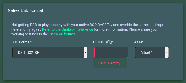

Once a DSD format is selected, two more configuration options will appear. The first is USB ID, short for USB identification code. This is a unique identifier for your USB DAC.
If you do not know the ID, you can click on the magnifying glass and Snakeoil will detect the first USB DAC in your system. To prevent false positives, please ensure you connect <u>ONLY</u> the native USB DAC to your Snakeoil PC.

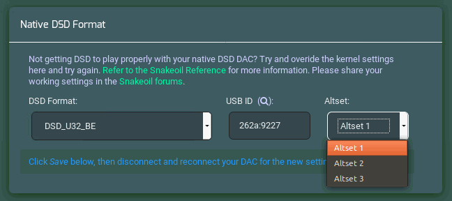

Altset Profile
Select the Altset profile for DSD output. Again please refer to your DAC manufacturer for the correct parameter.
Saving Your Native DSD Configuration
Scroll to the bottom of the page and click the "Save" button.
Your setting is now applied to your DAC.You can disconnect and re-connect the USB cable of your DAC to apply the new configuration. A correctly configured DSD player will bitstream the DSD file with the specified DSD format you specify above.  Unless you swap your DAC frequently, this  DSD configuration will be a set once and forget.
