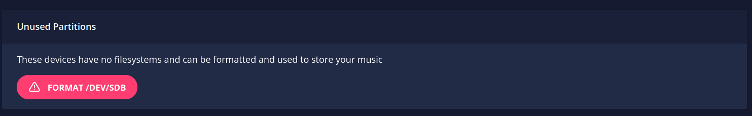

There are two ways of adding more local storage. Format the drive on another computer, and then connect it to the machine. Or connect the bare drive to the machine, and have Snakeoil format the media for you. To format any bare drive, simply select all the HDD labels in the "Uninitialised" table you want formatted, and then click the "Save Changes" button from the command panel.

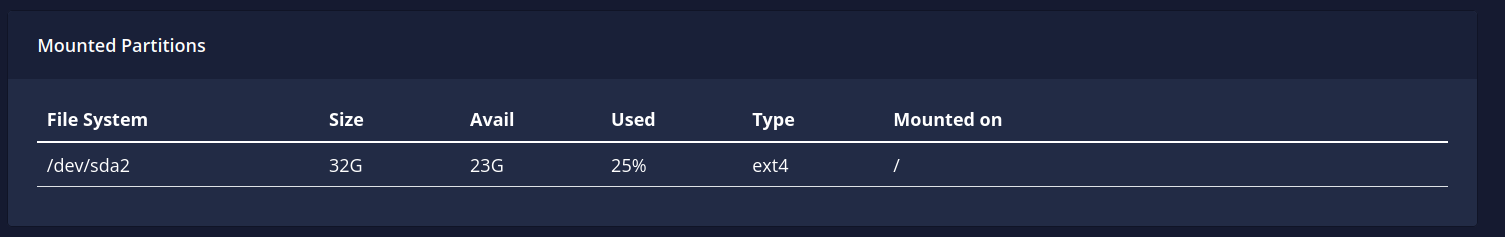

Mounted Partitions

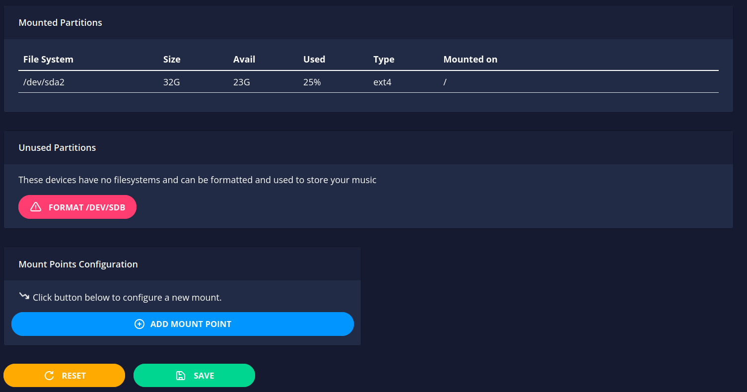

This panel gives you a quick summary of all storage (including removable media such as SDHC cards or USB HDD) that are connected and used by your Snakeoil OS machine. This is an example of a one disk setup. With one disk, no further configuration is necessary as everything will be stored on sda. You can monitor your disk usage by looking at column marked "Avail" to estimate how much free space you have on this device.

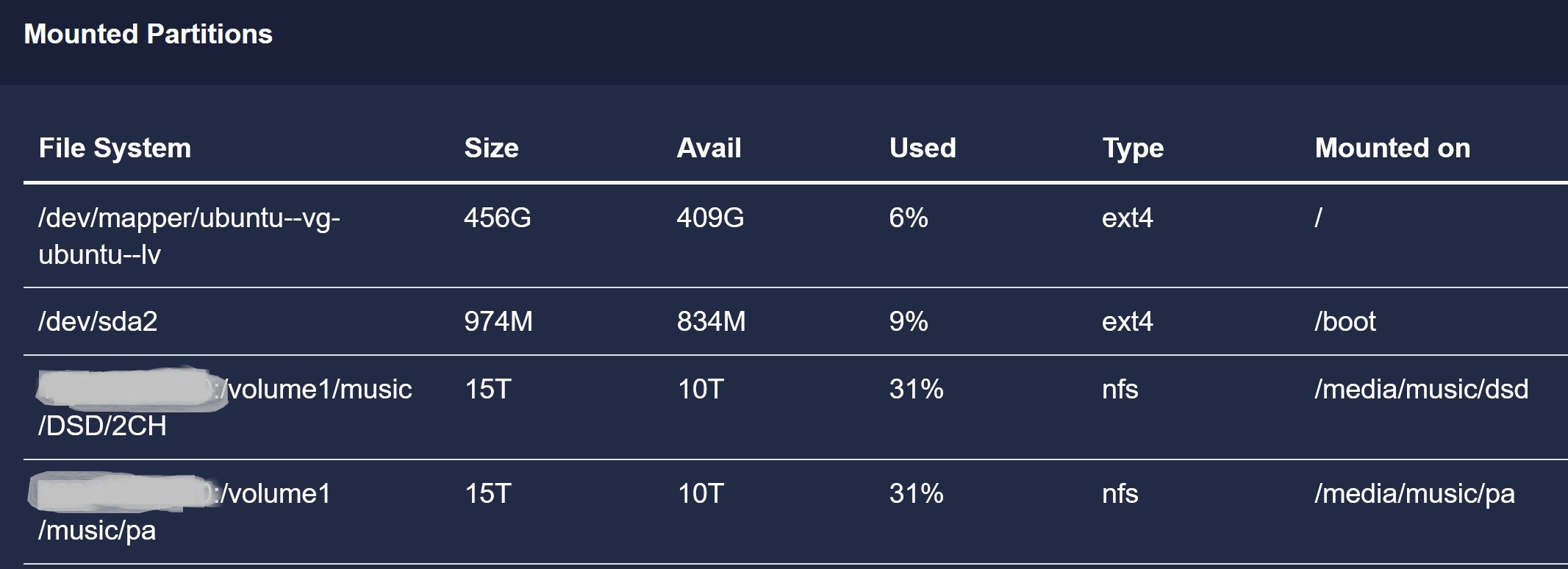

The next example shows a multiple media setup, note they are all mounted in the "/media/music" folder. In this example, The device in the first row (/dev/sda1) is the drive where Snakeoil OS is installed. The second drive (/dev/sdb1) is a second SSD and is mounted under "/media/music/wave". The third and fourth are network shares from two different NAS boxes (using the NFS and CIFS protocol respectively).

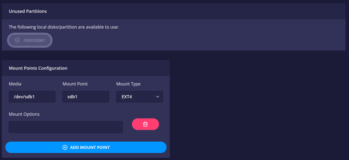

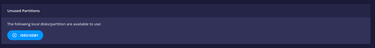

This panel only shows up if you have any unformatted or free device that is available for use. In the following example, "/dev/sdc1" can be mounted.
The following is an example of a brand new SDD, ready to be used in Snakeoil OS.
Once you click on any device in the "Uninitialised Device" panel, you should expect to see a corresponding entry show up in the "Mount Points Configurations" panel. Make any changes if necessary, and click the "Save" button to submit the changes. If things work as expected you should see the device show up in the "Mounted Partitions" panel at the top.

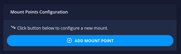

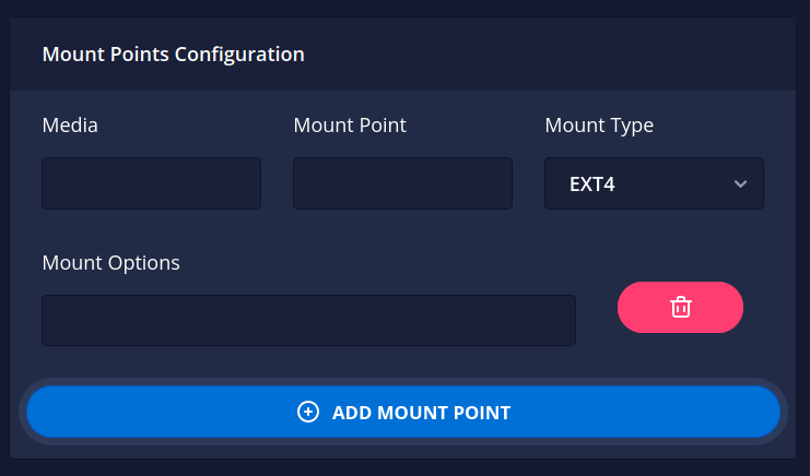

In this panel you can add or remove mounts for your Snakeoil OS. Click on the "''Add Mount Point''" button to create a new entry. Note that you can only have 1 entry if you are using an un-activated edition of Snakeoil OS.
The fields of the entry are described as such:
  • Media: This is your storage device. This can be hard disk on your system or network shares (CIFS or NFS protocols). Refer to the next section for info.
  • Mount Point: All media are mounded in /media/music. Therefore when you enter something like library, the device will be mounted under /media/music/library.
  • Mount Type: Specify the file system of your medium. Supported formats are - CIFS, EXT4, NFS, NTFS and VFAT (FAT32)
  • Mount Options: Tweak options you can use. This is still experimental and may not do anything.
  • Delete: This is a red button with a picture of the trash can icon. Click on this button to delete the entry. The medium will be unmounted when you click "Save".

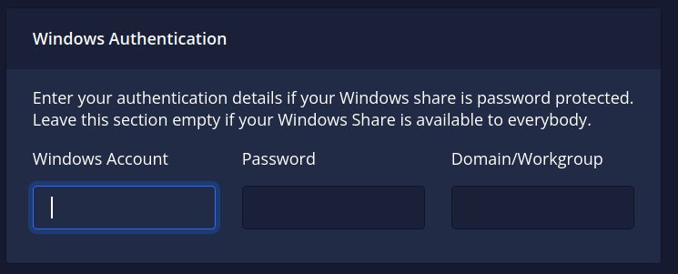

If you  have ACL setup for your Windows shares, you'd need to put in your windows login details. Be warned that the password is stored in plainstext on your Snakeoil OS computer, so please use guest shares whenever possible.
