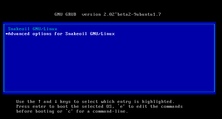

Connect the monitor and keyboard, boot up the computer and hit any arrow key immediately until you see this screen. You only have a short window to do this, reboot the machine again if you are not quick enough.

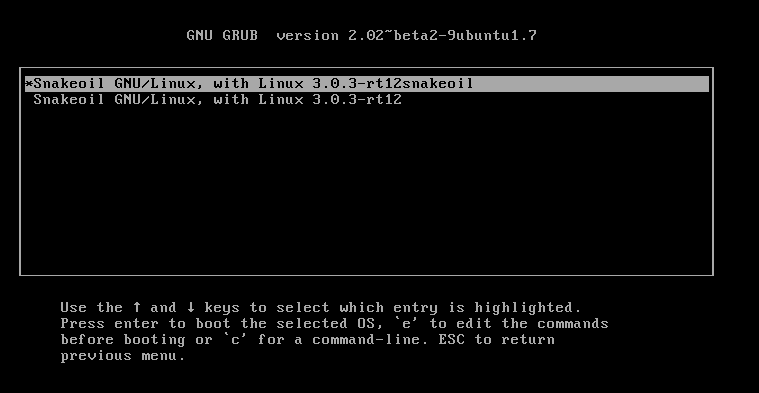

Once you see the screen above, make sure the entry "Advanced options for Snakeoil GNU/Linux" is selected (see example below), and hit the "Enter" key. You should see something like this. Select the first line from the list (Linux 3.0.3-rt12snakeoil in the example) and press the "Enter" key.
The machine should boot up fine now. Return to the Snakeoil menu, and select another working kernel.
