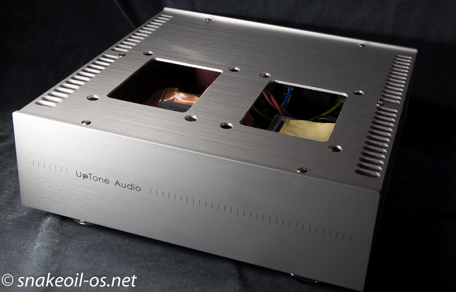

First up I'd like to show what modifications are made. Local DIY guru Don cut up the top plate of the JS-2 with his trusty CNC machine:

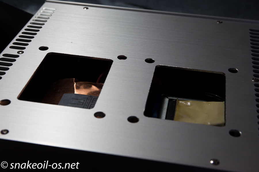

Here is different angle with the cut outs up close. The cuts are not as clean as Don's previous CNC projects, but this is immaterial in my opinion because the rough edges will be covered by the Hashimotos and be hidden from view anyway. You can see my lazy trait here as I did not bother to clean up the edges :P. Just made sure to remove all the burrs so that no stray aluminium will fall accidentally and short circuit something.
The modification effectively is to gut the JS-2 - remove the R-core, choke and the 2 capacitors (all expensive stuffs), and replace them with even more expensive parts - Hashimotos and Jensens.[adsense:][pagebreak]

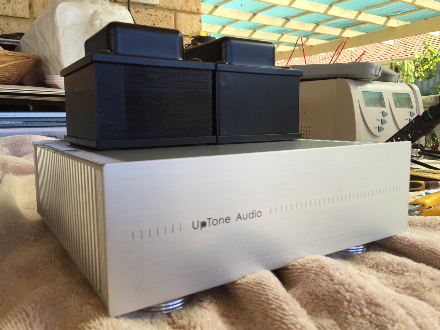

Here it is as modified by the PSU guru Chanh (Pictures courtesy chanh). He rotated the top plate 180 degrees so the Hashimoto transformer/choke now sits at the back:

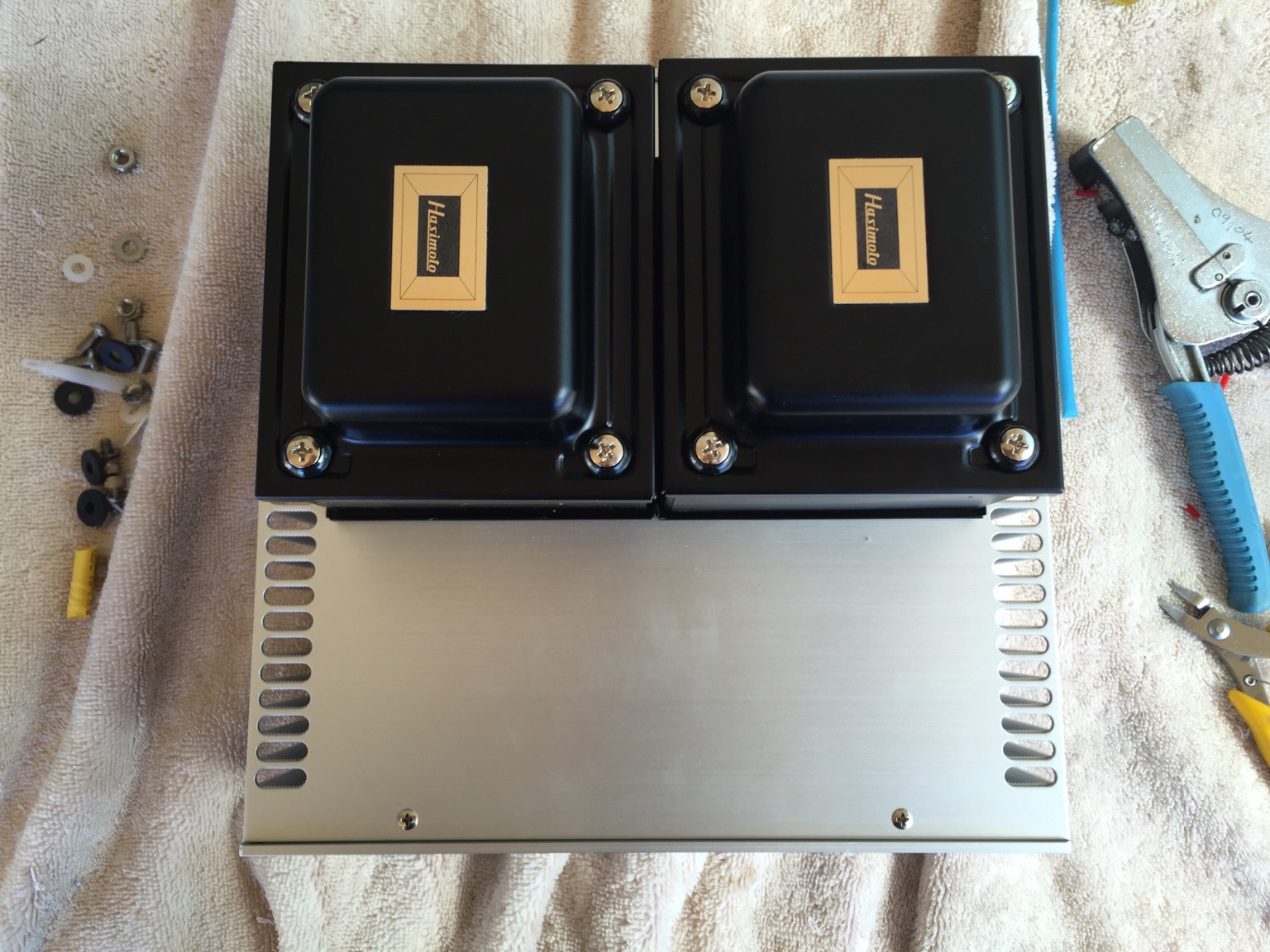

And the top view.

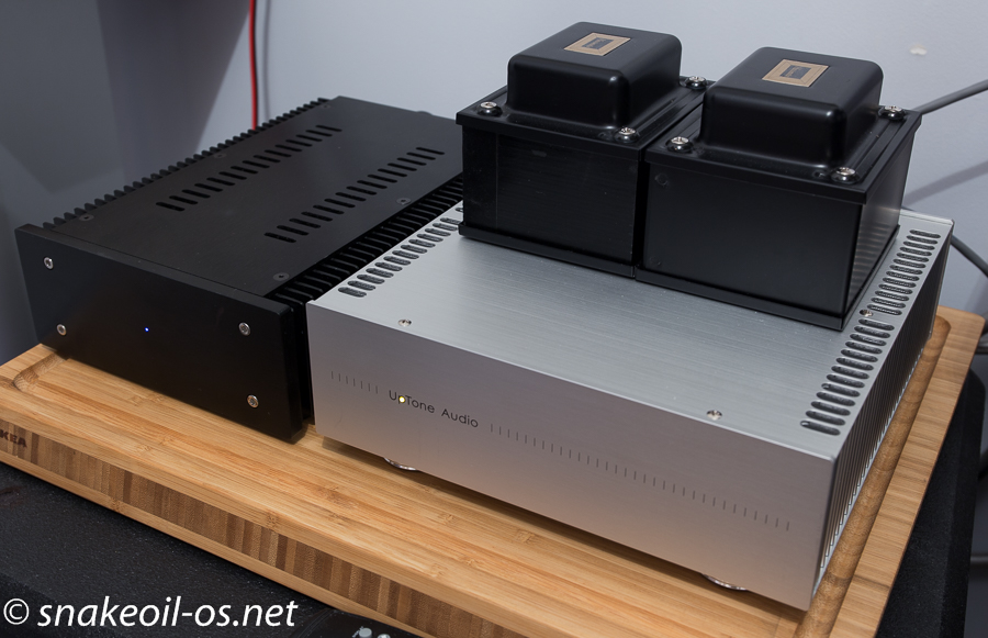

So this is the JS-2 in situ in my setup, now to me this look bad ass!
Yes, I'm going to say it, the modified JS2 makes the HDPlex looks like a toy, HDPlex just cannot sport the Hashimoto look. The biggest impact this medication brought to the table is the change of my perception when it comes to the noise level in my setup. Uncanny because the DAC I'm using is not the quietest piece of equipment out there (it's a DIY tube NOS and it's noisy!).
