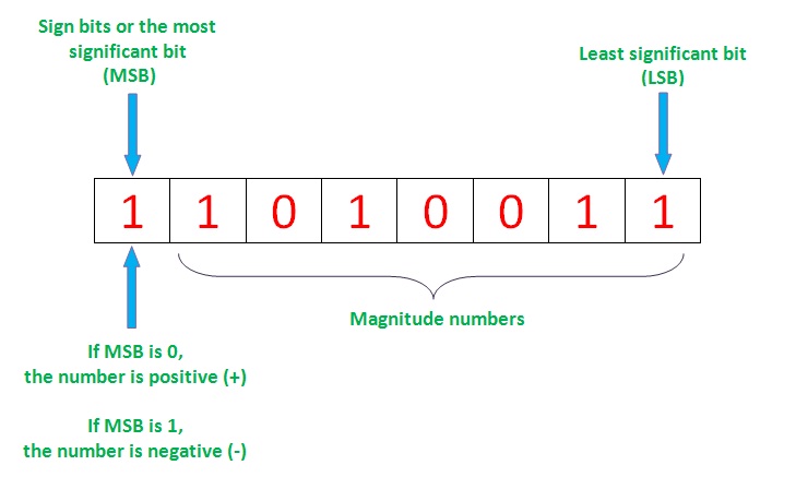

In the binary number system, the bit position gains more value (magnitude) as we move to the left (starting from the rightmost bit).
The right most bit is the first bit. Also called the least significant bit (LSB), this holds the value of 0 or 1, second bit holds the value of 0 or 2, the third bit holds the value of 0 or 4, until the last bit, the most significant bit (MSB). The MSB can be interpreted two ways:
- As unsigned char this holds a value of 0 or 128.
- As signed char this holds the sign (see figure above). Because the MSB is half the possible range of the bits before it- the range of values that can be represented by the unsigned char is now limited to between -128 to 127.

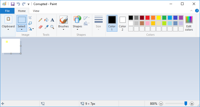

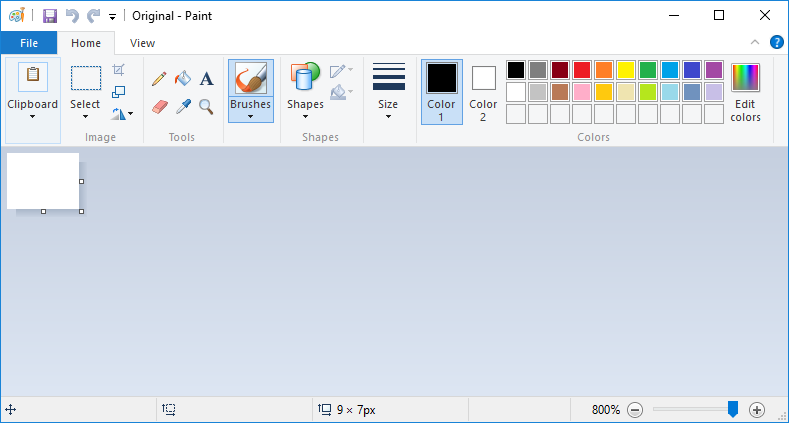

Here is a simple BMP file that is just 9 pixels wide and 7 pixels high. This BMP file is a blank canvas - only the white background and nothing else. This file is then loaded in Microsoft Paint, zoomed in to make it easier for you to see. At 100% this bitmap is extremely small, on a typical 1920 x 1080 screen this bitmap will only take up about 3% of the screen.
A single bit is then flipped in the file - and saved as Corrupted.png. The file is loaded and again zoomed to the maximum. The corrupted file shows a clear yellow spot in the top left corner. This yellow spot is just from a single bit change.
At the original resolution this yellow spot will be very difficult to spot indeed.
The above is an exaggerated example that makes bit rot easier to spot . The resolution of this example is a mere 9 by 7 pixels (total of 63 pixels). The resolution of a modern cameras like the Canon 1Dx is 5184 by 3456 pixels, that's 17,915,904 pixels in total.
Imagine trying to spot about 3 pixels of error from a picture with a pixel density of nearly 18 megapixels. The error(s) will be impossible to spot indeed - in most cases these errors will look like digital noise.

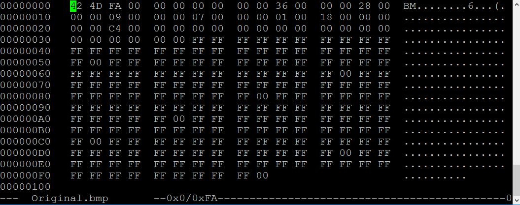

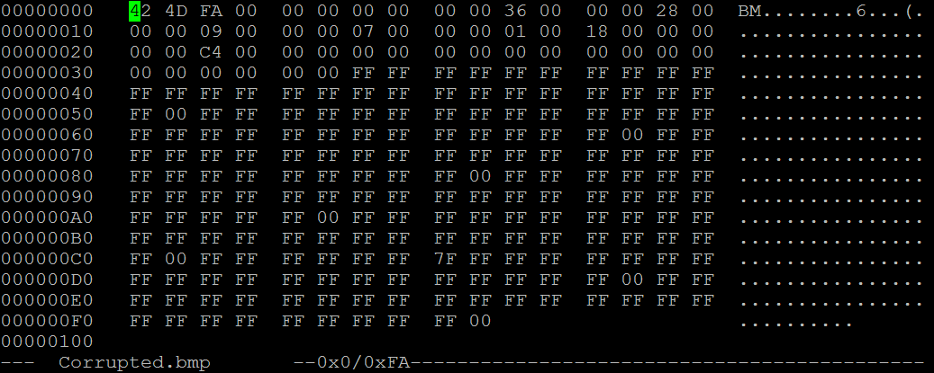

This is the hex1 dump of the original bitmap. You can recreate the file from the previous example by using a hex editor and enter these values:
Here is the hex dump of the corrupted bitmap, almost identical, except for one small difference.
Can you find it?
The difference between the two files is at position 0x000000C8. Look at the row labelled 000000C0, and then count 8 columns from the left. The original file has a value of 0xFF, while the corrupted file has a value of 0x7F.
Original Representation | Original Value | Corrupted Representation | Corrupted Value |
1111 1111 | 255 (FF) | 0111 1111 | 127 (7F) |
So the two files are identical in almost every way except for that single bit. A single bit flip caused that yellow spot you saw in the previous page. Over time as more bit rot creeps in the picture will change, and because the rotting is unpredictable and random, it is really hard to say for certain what the result will be.

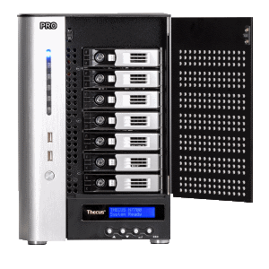

Since sometime from 2010, I've been using a NAS. My first machine is a 7 bay SOHO NAS made by Thecus - the 7700PRO. All my photos, music, movies and a ton of Animes I've collected since my childhood have been transferred from various medium and storage to this NAS.
The N7700Pro faithfully serve my digital content for well over 6 years, until I begin to notice something strange. The data that I copied and CRC32 (later MD5) checksum verified during the transfer stage start to show problems. These problems is usually over in a blank of a eye so I did not really pay much attention to it. The problems include:
- Video corruption. Corruption tend to happen to my MPEG2 encodings the most. In the worst case I can lose a few seconds of audio, video or both, but usually just a bit of corrupted section in a few frames.
- FLAC files will sometimes skip a fraction of a second, a brief moment of silence. If you're not paying enough attention you may well miss it.
- JPEG files start displaying weird coloured blocks.
Not a lot of files are corrupted. A rough number would be less than fifteen files from tens of thousands, with MPEG2 files (Copied from Video CDs accounting for the majority). This is enough to make me curious to investigate further. Easy enough for FLAC since it has a built in integrity checker.

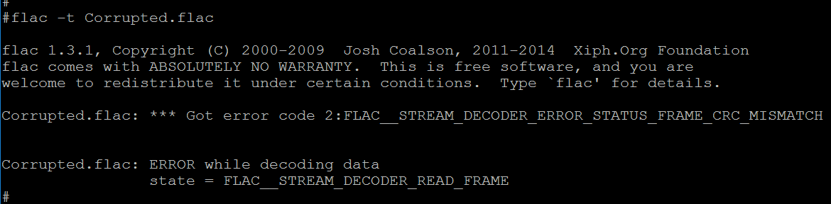

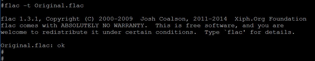

The FLAC format has the ability to test it's own integrity. You can invoke the test by using -t option with the FLAC command line utility, like so:
flac -t file_to_be_tested.flac
The following graphic is showing the output of a normal FLAC file (OK means all clear!):
Next I create a copy of this file (calling it Corrupted.flac), modify a single bit from 1 to 0 and run the test again. Testing now detect a checksum mismatch in one of the frames:
So knowing how FLAC testing works, I created a quick BASH script to run it through all my FLAC files for a given directory. To illustrate how rare bit rot really is, only 3-4 FLAC tracks failed this verification test. While my N7700Pro setup running RAID-6 using the XFS file system allow up to two disks to fail, unfortunately it cannot protect me from bit rot.

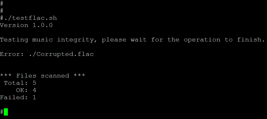

The Snakeoil Squad has created a quick Linux script that can test the integrity of your FLAC music library. The script is packed as a Snakeoil module and you can find this in the Snakeoil Technical Support Forums. Refer to the Snakeoil Technical Reference on how to install a Snakeoil module.
Once installed, you need to SSH into your Snakeoil machine and run the script like so:
cd /media/music
./testflac.sh
You can see a sample of the output here, corrupted files will be listed with the prefix of Error. Files that past the test will not be shown, so please be be patient and wait for the process to finish. Ideally you'd only want to see nothing at all pop up on the screen. At the end of the run the total number of FLAC files tested will be shown, along with the number of detected corrupted files. Like so:
You'd also get another file called testflac.log if there are any corrupted files. This file is located in your home directory and it contains a list of all the files that failed the integrity test. For example:
#cat ~/testflac.log
./Corrupted.flac
